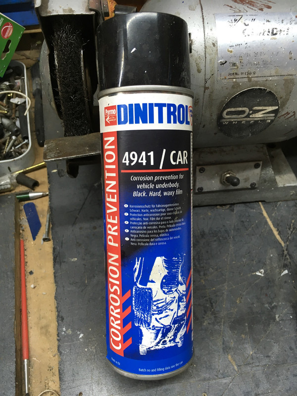

Congratulations on the purchase 👍🏻👍🏻 This is the stuff I used on my current RAV4.

The Dinitrol 4941 as per Bobs picture is the exact type I used. It Doesent go hard and stays slightly waxy to the touch.
